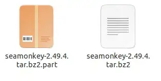

I got a tar.bz2 file but the help I found didn't help so I thought I'd ask here.
I downloaded the linux 32-bit file on their main site. My system is 64-bit.
The link on that site downloaded these files:
downloaded files
