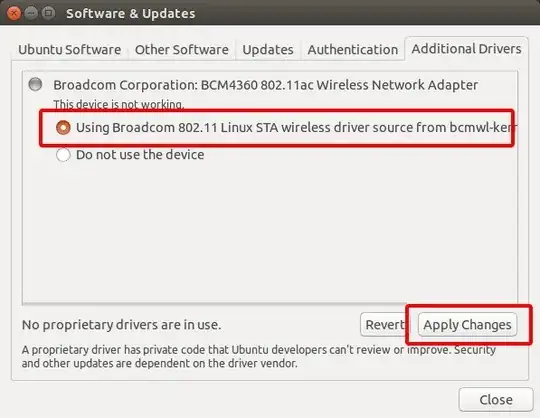

Then reboot your lap, check wifi signal. If it doesn’t show, go to Unity Dash and look for Software & Updates, then Next is to go in Additional Drivers tab and select the propriety driver and click on Apply Changes.
screenshot
