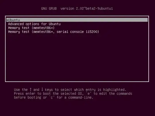

  1. Immediately after the motherboard / computer manufacturer logo splash screen appears when the computer is booting, with BIOS, quickly press and hold the Shift key, which will bring up the GNU GRUB menu. (If you see the Ubuntu logo, you've missed the point where you can enter the GRUB menu.) With UEFI press (perhaps several times) the Esc key to get to the GRUB menu. Sometimes the manufacturer's splash screen is a part of the Windows bootloader, so when you power up the machine it goes straight to the GRUB screen, and then pressing Shift is unnecessary.
  2. From the GRUB screen select Advanced options for Ubuntu and press Enter.

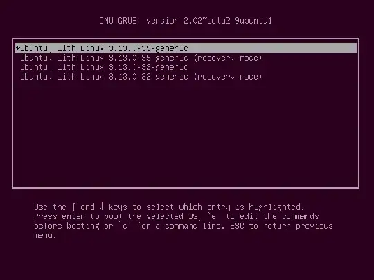

  1. A new purple screen will appear showing a list of Linux kernels, which includes options of booting the kernels normally or in recovery mode.
  1. Use the arrow keys on the keyboard to select an earlier kernel version and press Enter to boot with the selected kernel.
