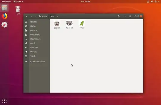

As a test I setup a VM with Ubuntu 16.04 LTS, configured some custom icons I stored in ~/Icons and then upgraded it to 18.04. After upgrading the custom icons were still present.
Custom icons in Ubuntu 16.04 LTS
Custom icons in Ubuntu 18.04 after upgrade
