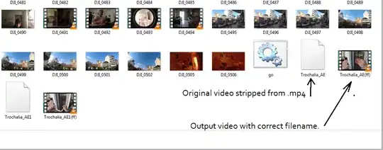

Since it was bit of a trouble to mess with much code, I just added a rename command before encoding starts and removed the .mp4 extension.
ren Troc*.mp4 Troc*.
for %%a in ("Troc*.") do "F:\Dropbox\PortableApps\ffmpeg" -i "%%a" -c:v libx264  -crf 22 -c:a aac -b:a 128k "%%a(ff).mp4"
Here's a screenshot from my folder:
thumbnails appear correct for files with adjusted names
