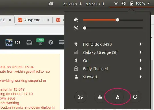

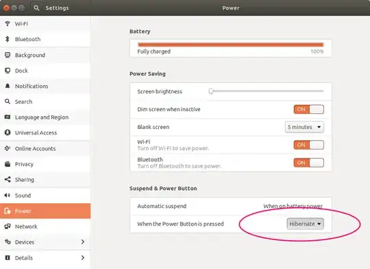

I have a Hibernate option in the shutdown menu thanks to this plugin and I have a Hibernate option under Power Settings.
How do I get these GUI options to use the Hibernate which works - the pm-hibernate - instead of the broken Hibernate?
