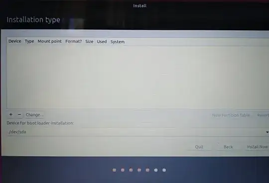

I want to install Ubuntu 18.04 alongside Windows 10 using a USB flash drive on an Asus K401UQ laptop - i7 6th gen, 8GB RAM, 1TB HDD + 24GB SSD.
I have left enough unallocated space to install Ubuntu using the - diskmgmt.msc - Windows 10 application.

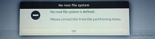

The problem is I can't find the hard disk when I try to install it as shown in the below screenshots.
image 1
image 2

The problem is probably caused by the UEFI settings in your BIOS that gives Win 10 full control. You need to modify the EFI settings and disable Secure Boot feature. It should give you access to the drive.
