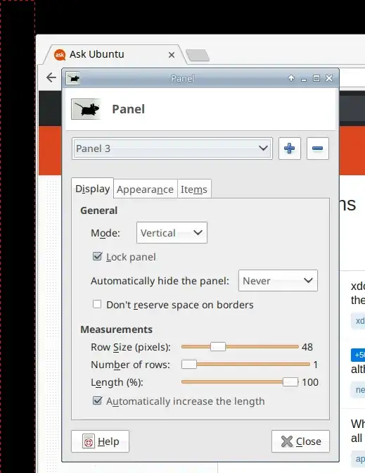

I don't see why you would want to do this, it might even cause burn-in problems depending on your monitor, but instead of changing the display (xrandr) resolution/display/pixels, try this:
  • Make some new XFCE panels on the top, sides, and bottom, with a solid black colour (in the Appearance tab) and options like this in the Display tab (changing the Row Size to however thick you prefer):
    Maximized windows will not cover the panels, and you could even use one side as an extra-large status / window panel (if your desktop is like that, similar to XFCE's defaults). I'm pretty sure every desktop has some sort of panels that should work similarly.
