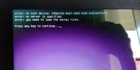

I then realised that the secure boot was disabled in the BIOS, wanted to change this, and disabled legacy mode support and enabled secure boot. For some reason my machine doesn't boot now. It shows the error as displayed as in the screenshot below: enter image description here
If I disable secure boot (Note: only secure boot, but still leave legacy mode support disabled as well), then the boot works perfectly again.
Note: In the image the device with UUID beginning with "29bb6762" is my boot partition.

  • and /dev/mapper/system-boot has the same device id as the grub error in the screenshot.

Ubuntu doesn't have a true secure boot option (it switches to insecure mode right away when secure boot is properly set up with it), but you can use the secure boot shim anyway if you need to turn on secure boot in BIOS/UEFI (like if you dual boot with an OS like Windows 10 that requires it).
Try this:
  1. Switch back to legacy boot in the UEFI/BIOS menu.
  2. Boot Ubuntu.
  3. In a terminal, run:
    sudo apt update; sudo apt install shim-signed
  4. Switch back to secure boot in the UEFI/BIOS setup. You may need to pick a bootloader to use for the Ubuntu boot menu option. If so, it's EFI/ubuntu/shimx64.efi.
  5. Attempt to boot Ubuntu.
