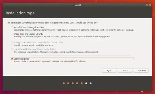

Download 18.04 .iso and use Etcher or Rufus in Windows to create a bootable USB thumb drive and restart the PC. Ubuntu will load and ask you to "Try Ubuntu" or "Install", you can select Install.
Follow the installation as normal until you reach the part asking you about partitions and select "Something Else" like here: enter image description here

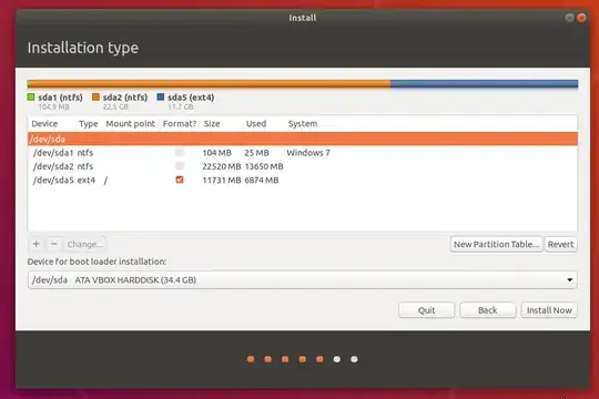

On the next page you will be shown the partitions:
  • Double click the Linux Mint partition
  • Select Ext4 journaling file system
  • Check Format the partition
  • Select / for the mount point
