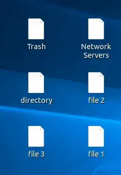

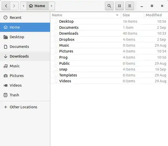

After starting up my PC today I have noticed that all of the icons in both the Gnome desktop and in the Nautilus file explorer have all turned blank white, even the directory icons.
Desktop:
File explorer:
Restarting Gnome or rebooting the system doesn't help.
This is annoying and very disruptive, is there any way of fixing this without reinstalling Ubuntu?
