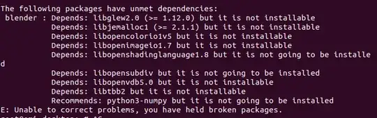

I'm new to Ubuntu and when ever I try to update or install blender, I encounter this error in the terminal.
This is the error that pops up:
https://i.sstatic.net/CSssk.png
Could someone tell me what exactly to do?
I have used the following code as suggested in blender website,
sudo add-apt-repository ppa:thomas-schiex/blender
sudo apt-get update
sudo apt-get install blender
You don't need to add any repository; simply run
sudo apt install blender
It's available by default, you don't need thomas-shiex repo.
Or alternatively you can do
sudo snap install blender --classic
