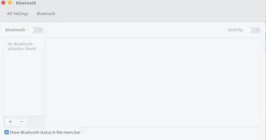

I have already had bluetooth problems, it disappeared after suspending and then I found a solution by updating to a newer kernel version. My mouse worked for several weeks... suddenly today out of NOTHING my bluetooth is completely gone! Even after reboot I can't get it back!
Does anybody has similar problems on 18.04 ? Maybe it has to do with some system updates from Canonical? Does anybody know what could help to get bluetooth back?
This is what the bluetooth menu shows me, everything is just greyed out:
enter image description here PS: This is SO annoying! Is there a good place to report all these bugs to Canonical? Something like a Guthub issue tracker?

My solution was:
Shutting down, waiting a few minutes and then turning on again worked for me.
No restart! Multiple restarts (about 10x) didn't help!
PS: If this still doesn't work, try to turn off the bluetooth-device inside bios, then restart and turn it on again.
