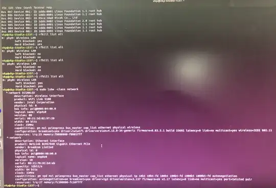

I have updated ubuntu from 16.04 to 18.04.
The system has worked properly for one day.
After that it started to switching between airplane ✈️ mode on and off continuously.
