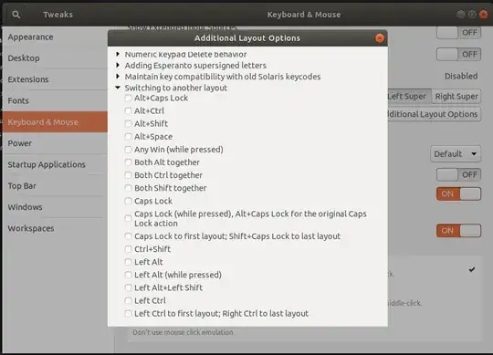

Gnome Tweaks helps me to fix it!
  1. Go to Keyboard & Mouse > Additional Layout Options.
  2. Turn off all options for "Switching to another layout".
    Gnome Tweaks layout switching options

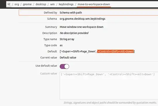

I had a similar issue recently, while trying to use this keys combination inside vscodium, in Ubuntu 20.04
ctrl + shift + alt + up or down not working as I entend, since it changes the working space instead of the expected function inside a code editor
First approach
Trying to fix it through:
  1. Activities > Setting > Keyboard Shortcuts
  2. Navigation > Move to workspace above/bellow
didn't work either, because this keys combinition: ctrl + shift + alt + up/down, doesn't show there
Solution
  1. install dconf-editior
    sudo add-apt-repository universe # active by default, but just in case
    sudo apt update
    sudo apt install dconf-cli dconf-editor
  2. go to:
    /org/gnome/desktop/wm/keybindings/move-to-workspace-down
  3. disable Use default value
disable: Use default value

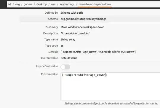

  1. edit Custom value: by removing
    <Ctrl><Shift><Alt>Down
edit: Custom value
  1. Apply
  2. follow the same steps for Up (instead of Down)
    /org/gnome/desktop/wm/keybindings/move-to-workspace-up
  3. log out/in
Result
