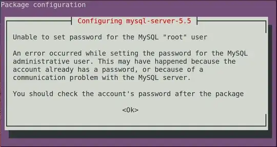

I've tried removing and installing MySQL several times and I always get the same message:
Do you want to continue? [Y/n] Y
Setting up mysql-server-5.5 (5.5.61-0ubuntu0.14.04.1) ...
start: Job failed to start
invoke-rc.d: initscript mysql, action "start" failed.
dpkg: error processing package mysql-server-5.5 (--configure):
 subprocess installed post-installation script returned error exit status 1
dpkg: dependency problems prevent configuration of mysql-server:
 mysql-server depends on mysql-server-5.5; however:
  Package mysql-server-5.5 is not configured yet.
dpkg: error processing package mysql-server (--configure):
 dependency problems - leaving unconfigured
No apport report written because the error message indicates its a followup error from a previous failure.
                                      Errors were encountered while processing:
 mysql-server-5.5
 mysql-server
E: Sub-process /usr/bin/dpkg returned an error code (1)
