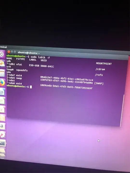

I've always installed Debian/Ubuntu without problems with Windows but this time I cannot. I had a w10/debian9 build but I wanted to start from 0 so I formatted my partitions and reinstalled my os. There wasn't problems for w10 but I couldn't install any Linux distro, I tried with Mint 19, Ubuntu, Kubuntu 18.04 and 16.04 and it always says that I have no space when installing even though my disk has 930 GB empty space. I tried to restart even my partition tablet. I don't know what to do, any idea?

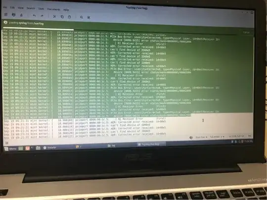

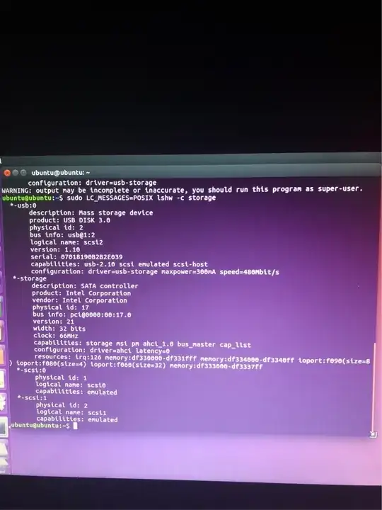

Edit: I post pictures since pc gets mad and doesnt allow me to copypaste. I added syslog where my PC starts to iterate this error. Any idea?
Edit2: I finally got the solution that was to add pci=nomsi after quiet splash as grub boot parameters
GParted screenshot sudo lsblk -f screenshot LC_Messages=POSIX lshw -storage screenshot
syslog
