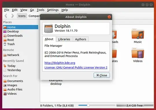

Newer Dolphin may be obtained from KDE FlatPak repository:
flatpak remote-add --if-not-exists flathub https://flathub.org/repo/flathub.flatpakrepo
flatpak remote-add --if-not-exists kdeapps --from https://distribute.kde.org/kdeapps.flatpakrepo
flatpak install kdeapps org.kde.dolphin
The command above will download org.kde.Platform/x86_64/5.11 (about 332 Mb), org.kde.dolphin/x86_64/master and org.kde.dolphin.Locale/x86_64/master. Logout from your account and login back. Then search in dash for Dolphin and launch it:
Dolphin 18.11.70 on Ubuntu 18.04 LTS GNOME
(you got Dolphin 18.11.70 running on Ubuntu 18.04 LTS).
