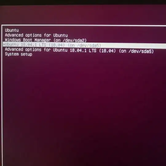

Important is, when installing Ubuntu on USB stick (sdc) i choose boot-loader for installation as sdc. which was this USB stick.
now grub is controlled by this stick. if i remove this stick, system will come up with grub prompt.
i have to type "exit" to boot to windows10.
if the stick is present it will give the options where i can select Ubuntu which is on my ssd. if i remove the stick and start the system, it will come up with grub prompt again where i have to type "exit" to boot to windows10.
Once i am Ok with the setup, i have edited the /etc/default/grub file on sdc so that when i insert this usb and start, system directly boots to Ubuntu on SSD without even showing grub.

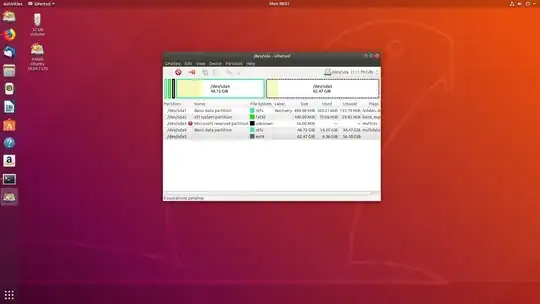

  1. open GParted from live session and see what are the partition numbers of efi & ext4 /. mine are sda2 and sda5 respectively.
