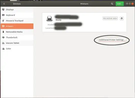

System Setup > Devices Printers
Do not click on the Green Add... button on top. Click on additional printer settings... circled above.

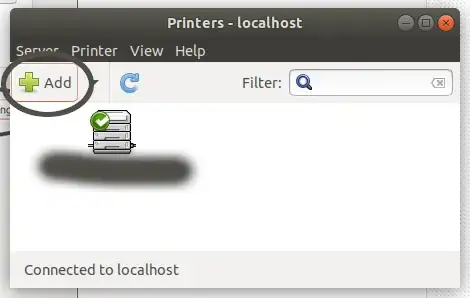

You should see a smaller window with +Add button on top left:

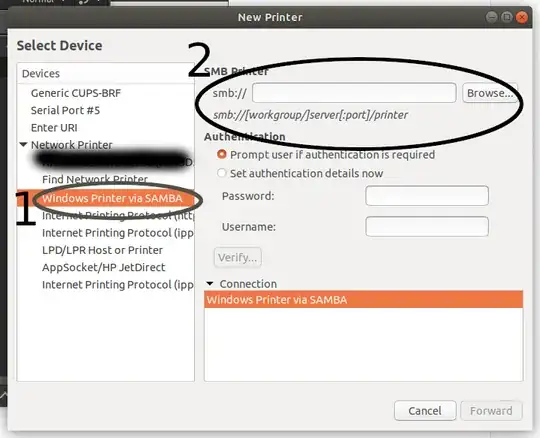

In the New Printer window select Windows Printer via SAMBA:
Then fill in the printer server detail. You may also click the browse button and search for printer servers.

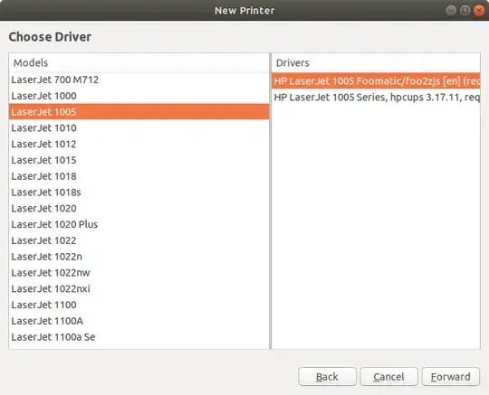

Select HP as the printer manufacturer and then then scroll down to find your printer:
Click forward and complete the process.
