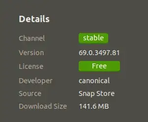

If you installed the browser from the Software Center, you need to know there are two possibilities:
Two versions of the browser
The one named "Chromium" is what is known as a snap version and you can read more about snaps here.
The snap version
Notice the source is the Snap Store and the download size is 141.6 MB.
