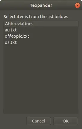

Open a text editor and press the assigned shortcut to launch texpander.sh. You'll get a Zenity window like this:

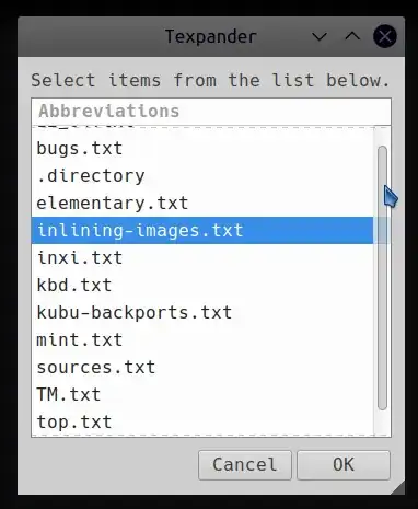

Texpander choices
If you have a longer list, there'll be a handy scrollbar or just type the first letter of a listed item to jump down the list to that item.
Select the one you want and press Enter or click OK.
A longer list with scrollbars
