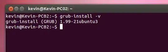

On clean ubuntu installs the grub package itself doesn't seem to be installed. Thus typing 'grub -anyoption' results in an error that says grub is not installed. However you can type for example
grub-install -v
And it will give you the correct version of grub currently installed
The version of the Grub is 1.99-21ubuntu3
EDIT: As others have pointed out the commandline flags have been changed in newer versions. So now instead of typing grub-install -v you'd have to use a capital 'V' or the explicit --version
