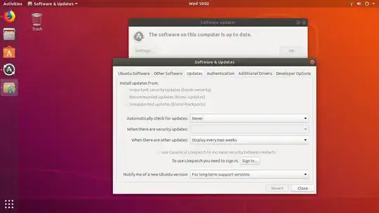

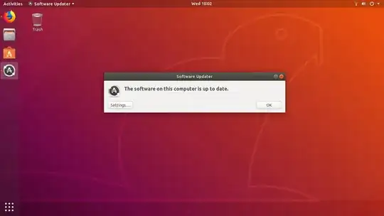

i thought this would help, so i un tick like below.
enter image description here enter image description here enter image description here enter image description here
also i would like to know, which commands in terminal will update the OS, so that i will not run them.
