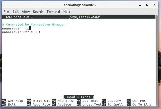

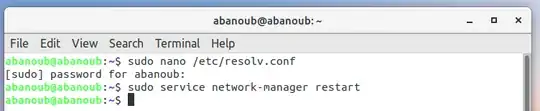

Here is what I do:
And the result is:

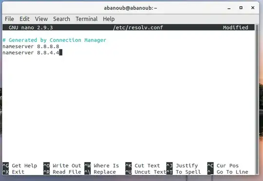

I then change it:
And after restarting network-manager, wifi works correctly
