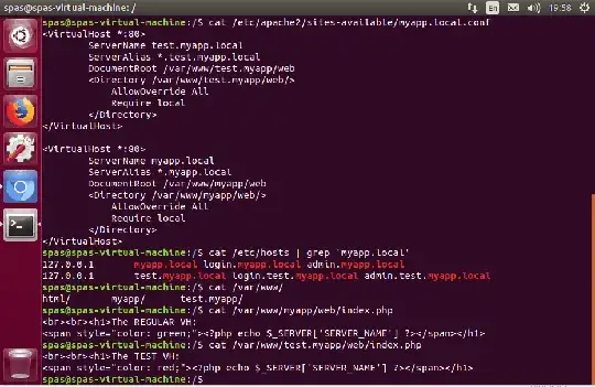

Thus the requests that doesn't match to the first virtual host will fall into the second. Here is how it's working on Ubuntu 18.04 with Apache/2.4.29:
