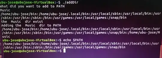

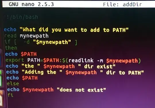

I wrote a script to add a dir to the PATH environment. When I run the script it runs fine and the dir is added to the PATH. But it seems that the change only lasts until the script exits instead of lasting for the length of the session. When I look at the PATH after the script is ran the dir is no longer there. Any suggestions?

Given this slightly simplified version of your script...
read -rp "What did you want to add to PATH? "
[ -d "$REPLY" ] &&
PATH="$PATH:$(readlink -m $REPLY)" &&
echo "OK, adding $REPLY to PATH" &&
echo "$PATH" ||
echo "seems like $REPLY is not a directory"
Notice that I get the same result as you when I run the script in the usual way:
$ ./add-to-path
What did you want to add to PATH? /home/zanna/playground
OK, adding /home/zanna/playground to PATH
/home/zanna/bin:/usr/local/sbin:/usr/local/bin:/usr/sbin:/usr/bin:/sbin:/bin:/usr/games:/usr/local/games:/home/zanna/playground
$ echo $PATH
