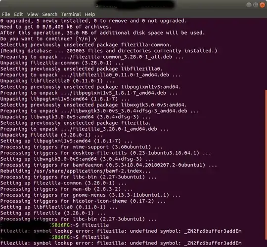

I did a full remove and purge of filezilla and after that installed the latest from the Ubuntu Software library (version 3.28), and started filezilla from the terminal. (Please see picture attached for the errors)
error on restarting filezilla
$ filezilla
filezilla: symbol lookup error: filezilla: undefined symbol: _ZN2fz6buffer3addEm
Any help and guidance will be appreciated. Thanks in advance.

Your ldd output has one strange line:
$ ldd $(which filezilla)
libfilezilla.so.0 => /usr/local/lib/libfilezilla.so.0 (0x00007fc834bab000)
(it seems that you have installed filezilla from source before).
But correct line is:
libfilezilla.so.0 => /usr/lib/x86_64-linux-gnu/libfilezilla.so.0
So to fix the issue your should remove the problematic library manually:
sudo rm /usr/local/lib/libfilezilla.so.0*
and reinstall correct one from deb-package:
sudo apt-get install --reinstall libfilezilla0
