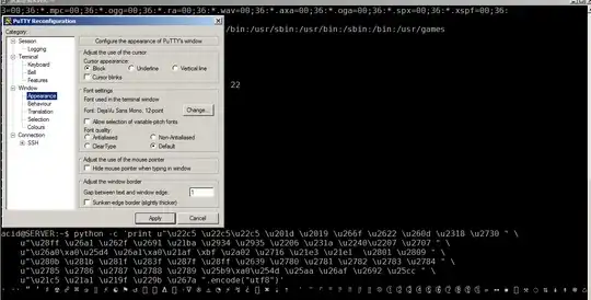

I have a console application which is displaying special symbols like
No matter where - putty(UTF8+Use Unicode line drawing, but I guess it's not client issue), local console, SecureCRT - I can't see them. Instead just squares. Here is my shell env variables
LANG=en_US.UTF-8
TERM=xterm
Any idea how to make terminal to show those symbols correctly?
Update
Glyph I am interested in
python -c 'print u"\u22c5 \u22c5\u22c5 \u201d \u2019 \u266f \u2622 \u260d \u2318 \u2730 " \
    u"\u28ff \u26a1 \u262f \u2691 \u21ba \u2934 \u2935 \u2206 \u231a \u2240\u2207 \u2707 " \
    u"\u26a0\xa0\u25d4 \u26a1\xa0\u21af \xbf \u2a02 \u2716 \u21e3 \u21e1  \u2801 \u2809 " \
    u"\u280b \u281b \u281f \u283f \u287f \u28ff \u2639 \u2780 \u2781 \u2782 \u2783 \u2784 " \
    u"\u2785 \u2786 \u2787 \u2788 \u2789 \u25b9\xa0\u254d \u25aa \u26af \u2692 \u25cc " \
    u"\u21c5 \u21a1 \u219f \u229b \u267a ".encode("utf8")'
Screenshot with Ubuntu font
Screenshot with DejaVu font

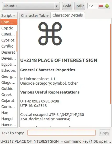

Unicode glyphs can be rendered using UTF-8 or UTF-16
thus Unicode U+2318 or UTF-16: 0x2318 or is UTF-8: 0xE2 0x8C 0x98
Font details for a character can be found by literally searching for it in character map. It is run as an icon utility or activated with the gnome-character-map or gucharmap terminal command. Press and hold the right mouse button over the character to identify the font of residence. Also, use Show only glyphs in this font in the View menu and then scroll through the font list with an arrow key to quickly find the character's font with other resident characters.
