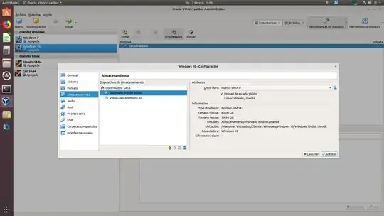

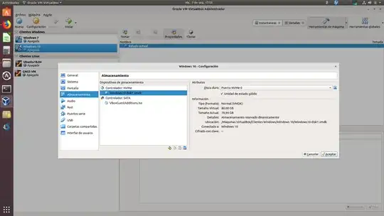

I have the latest Virtualbox 5.2.18 in a Ubuntu 18.04.1. I have a guest system Windows 10. I have a vmdk hard drive ( virtual drive) saved in a SSD disk ( the file .vmdk. So i have recently upgraded my system buying a NVME (Samsung SSD 970 EVO PCI-E NVMe M.2 500 GB). So i wanted to take advantatge and define the storage as:

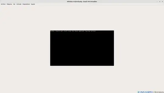

But i get an error when i want to boot:
So but if i use the same file .vmdk as SATA ( which ive been using these past years and stored in a ssd disk) it works perfect...

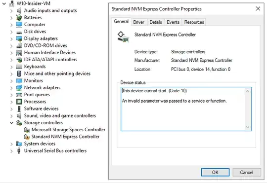

    • An existing Windows 10 Insider VM fails to detect the additional controller properly when booting from SATA.
      Windows device manager: This device cannot start. (Code 10) An invalid parameter was passed to a service or function.
