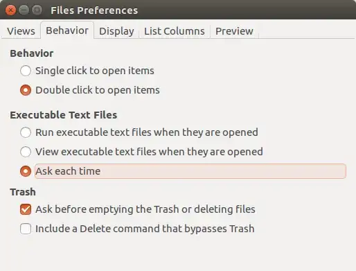

Within the desktop environment the behaviour of the executable files depends on the settings of your primary file manager. For example within Ubuntu 16.04 this is Nautilus. To change the behaviour: Open Nautilus; go to Edit menu and choice Preferences. Then click on the Behaviour tab. There are three options of the behaviour of the Executable Text Files:
Another way to execute a file within the desktop environment (while the option View executable text files when they are opened is selected) is to create dedicated .desktop launcher for that file.
