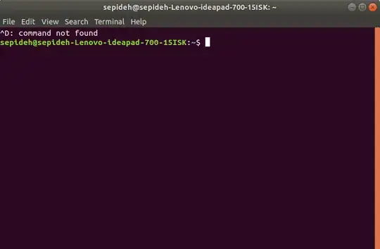

In one of my previous sessions using terminal, I typed ^D by mistake.
And now every time I start the terminal, there's this:
^D: command not found
What should I do?
I have used the command clear several times, but every time I start the terminal, that line appears again.

Because of installing Cisco AnyConnect client, I had typed
$ cat >> ~/.bash_aliases
alias vpn='/opt/cisco/anyconnect/bin/vpn'
alias vpnui='/opt/cisco/anyconnect/bin/vpnui'
^D
So the non existing command ^D was written in my ~/.bash_aliases file which is run every time I open the terminal.
To solve the problem, type:
nano ~/.bash_aliases
and delete the command ^D
