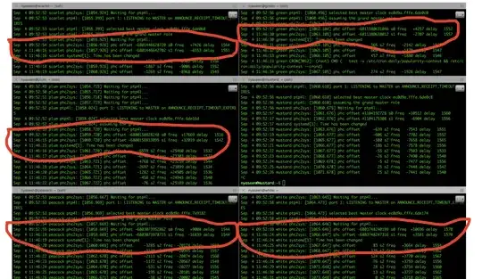

I am trying to synchronize clocks using ptp4l and phc2sys.
I followed this instructions. Unfortunately, I am seeing clock jumps: In 5 of the 6 servers, clock jumps by 2 hours. In the image, it goes from 9:52 to 11:46.
The issue was arising because of different timestamps on the CPU clock and the NIC. NIC was two hours ahead and caused the time to change for all other systems.
