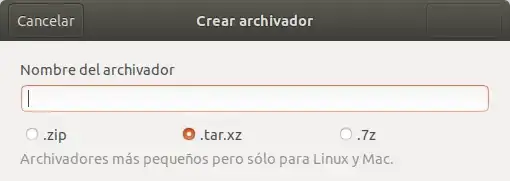

I am trying to zip in .tar.gz in the GUI, but only these options appear in the window: .zip, tar.xz y .7z
ventana
Could the tar.gz be in the window?

As mentioned in the comments of the question: The answer is no. They changed archival back-end to libarchive. But you can drop Nautilus and change it to Nemo or Caja.
Another alternative is to simply open the arvchive manager and drag the files and/or directories you wish to compress to the window. You will then be prompted to create a new archive. The location of the archive will by default be in the directory of the added item(s) and you will have the list of compression formats available, like you are used to from 16.04.

Simply, install Nemo file manager. It has a lot of compression options including tar.gz.
