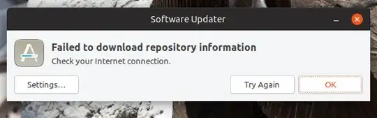

In the last few days, my system has started popping up an Ubuntu default web-browser and making a request to nmcheck.gnome.org website and immediately shutting off.
Since this happened, I cannot run system updates.
Also, I am a php developer and cannot run composer install or composer update
sudo apt update
software update
How can I find this script and delete it forever?
