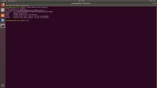

So I deleted all of those entries (excluding quiet splash) and booted up again. This time, before the computer froze I entered tty2 (Ctrl+Alt+F2), and then simply installed the nvidia drivers via command line.
I guess you only need to use the second one, but just to be thorough, here are both.
sudo ubuntu-drivers list (gives you the available drivers for your device)
sudo ubuntu-drivers devices (gives you their names)
Screenshot of terminal
If you have the name, you just install them with apt.
Example:
sudo apt install nvidia-driver-390
When it's done, reboot and rejoice.
