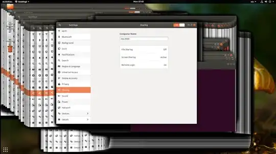

I can connect via VNC (by enabling the built-in 'Screen Sharing' option), but as soon as I turn of the local display (server is connected to a TV, not a regular monitor), the VNC connection stops working for anything but the active windows. In other words: the background and the dock are not refreshed and the connection becomes very difficult to use (see screenshot).
Anyone has any idea where to look for a solution? I saw some posts about adding a dummy monitor, but that does not seem to apply to my case. screenshot

I had the same issue on Intel NUC with Ubuntu 19.04 and solved it by disabling of KMS for Intel graphics:
  • Set GRUB_CMDLINE_LINUX_DEFAULT="quiet splash nomodeset i915.modeset=0" in /etc/default/grub
  • Run sudo grub-mkconfig -o /boot/grub/grub.cfg
  • Reboot
