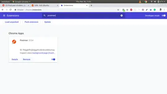

Hover on any extension and click manage extensions and then search postman and choose remove.
This will remove web app postman from Chrome.
edit 1: reply to comment.
If you can't see chrome extension, then click on any extension, then the extension menu opens where you can search for Postman, then click remove.
screenshot
