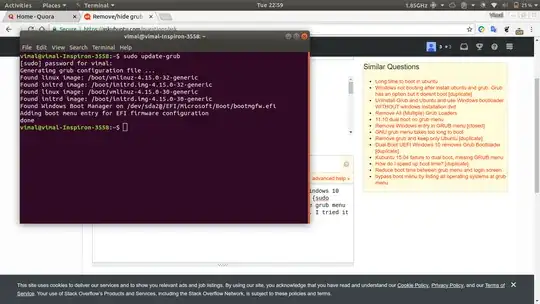

I have removed Windows partitions in order to completely remove Windows 10 and continue with Ubuntu. However, even after updating grub using sudo update-grub it still shows the Windows boot loader. Its output was this:

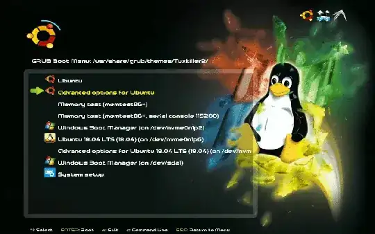

Grub defaults to a 10 second count down but you can shorten it to about 2 or 3 seconds which gives you enough time to interrupt it. In this example the 10 second countdown has been changed to 5 seconds:
To change the count down time use sudo -H gedit /etc/default/grub and find this line:
GRUB_TIMEOUT=10
Change it to a more reasonable time for you:
GRUB_TIMEOUT=3
