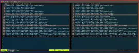

If the output of diff isn't sufficiently clear, consider using a more advanced tool, like meld, or my person choice: vimdiff. Using a similar example like @Sergiy, this is what Vimdiff shows me:
As can be seen, the extraneous whitespace is highlighted. More advanced diff highlighting can be obtained using the DiffChar plugin (see my post on Vi & Vim SE for an example).
