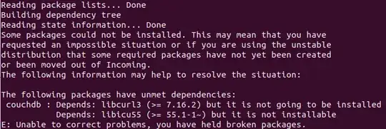

I ran the command sudo apt-get install couchdb -y then following list appeared.

libicu55 was supported until Ubuntu 16.04 Xenial, but it is compatible with 18.04 Bionic as well.
Add the following repository and install the package
sudo add-apt-repository "deb http://security.ubuntu.com/ubuntu xenial-security main"
sudo apt-get update
sudo apt-get install libicu55
Also you can install the .deb package manually:
sudo wget http://security.ubuntu.com/ubuntu/pool/main/i/icu/libicu55_55.1-7ubuntu0.5_amd64.deb -P /tmp/
sudo dpkg -i /tmp/libicu55_55.1-7ubuntu0.5_amd64.deb
