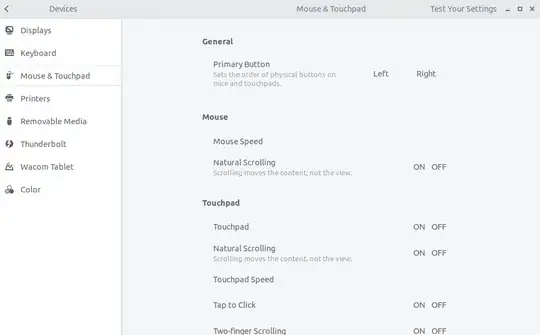

I recently updated to Ubuntu 18.04 LTS from Ubuntu 16.04 LTS. Since update, settings in ubuntu doesn't have proper selection highlighted.
See the screen shot, which selection is selected is not highlighted

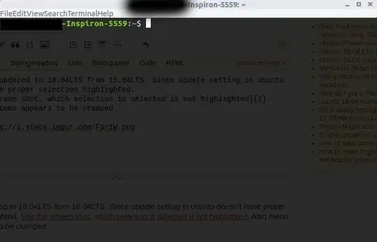

Also menu items appears to be cramped
 look at File, Edit, etc
Output of gsettings get org.gnome.desktop.interface gtk-theme is 'Arc'.
