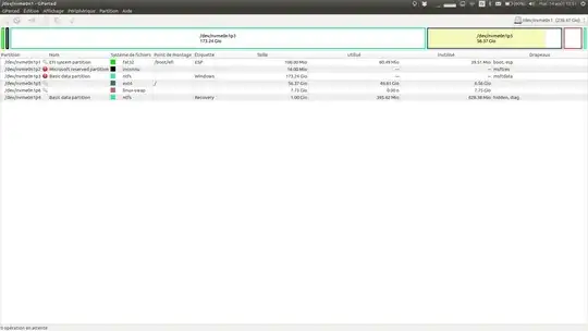

Gparted screenshot
When I'm trying to move/resize Windows partition, min size and max size are equal...

The picture shows exclamation marks beside the Windows NTFS partition. You can double click on the partition to view more information about the partition and the issue. This is commonly caused by an NTFS file system being left in an inconsistent state if it is not properly shutdown.
Try booting into Windows, and then shutdown Windows completely (not hibernate) and then try using GParted again.
