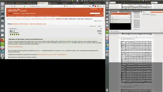

The problem: the bottom portion of the second screen (in portrait mode) constantly "flickers" randomly between what should be displayed, and something that used to be displayed. (After a random period of minutes, this mysterious "second buffer" eventually matches the screen...until I change it again.) I've tried moving the second monitor's configured location (in Displays) all around, but only succeeding in moving the location of the problem area on the second screen. This is not a hardware problem, as it shows up in screenshots: here's a screenshot of the problem:
Note that the affected area starts 1,138 pixels down from the top of the 2nd screen (only 58 pixels below the 1,080-pixel main screen). Not sure if that means anything or not.
How did I get the above screenshot? Well, when I press the "screenshot" button, Ubuntu quickly "fades" both screens from black back to normal, and one of the "faded" steps starts flickering randomly on the lower portion of the second screen (main screen is fine). Here a few minutes later, it's still flickering that "faded" step; if I scroll the document on the second screen, it'll start flickering back and forth between what used to be displayed there and the new material. Which poses quite a problem for the music I'm trying to read on that monitor!
It doesn't make any difference what program I use (in other words, it's not the Document Viewer at fault here)...if I "restore" the window to a smaller size, the affected area keeps flashing between what it should display and what it used to be displaying. It constantly flickers back and forth between the two, just like a bad connection in a wire (which it isn't if I can use screen capture to get a picture of it!)

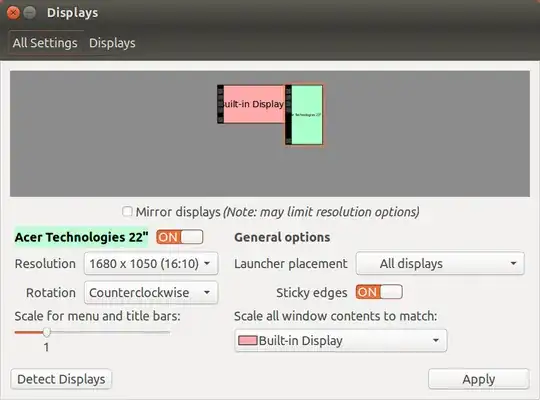

Here's my monitor setup in Displays:
