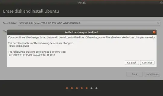

I installed Ubuntu with an external hard disk and now I'm running Ubuntu from this external disk and seems to work. Now I would like to install Ubuntu on the internal HD but the installation program shows these messages and errors here:
typed YES first message
typed Install now installation step
typed continue second installation message

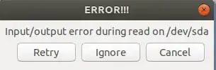

first error message
second error message

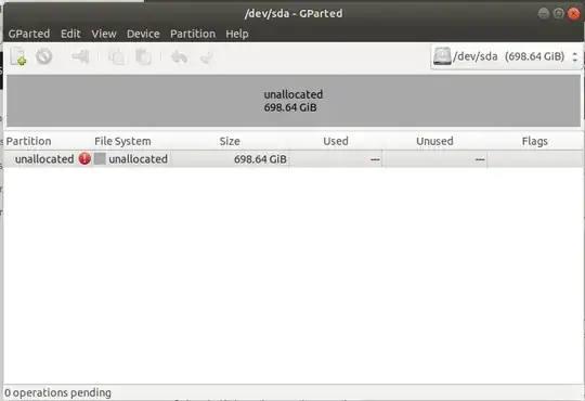

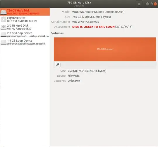

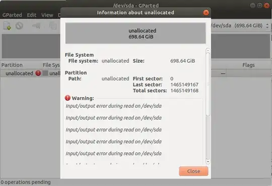

Arrived at this point, I've to quit the installation. I'm new to Ubuntu, I'm not sure if the internal HD works or it's already dead. Trying to find some more information about the internal HD this is what the programs Disks and GParted shows.
Disks Information
GParted Information
GParted Warnings
