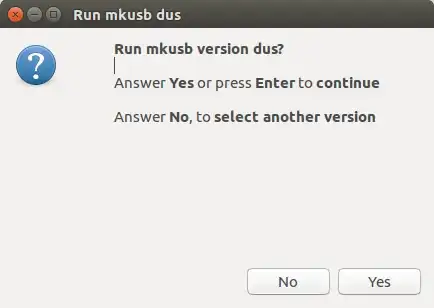

Next, run mkusb. It'll ask you if you want to run the version called 'dus', we want to hit Yes at that screen.

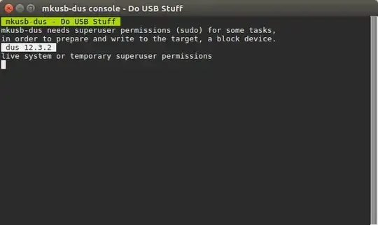

It will open a terminal window for the console output, which is very useful to have so you can see the progress of the write tasks.
It should prompt you for your sudo credentials as well, however I'm running this from a Live USB at the moment so it doesn't prompt me, it just goes to the next screen in the GUI:

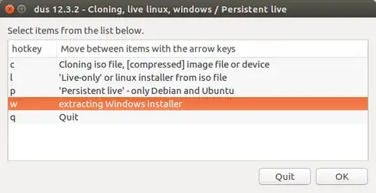

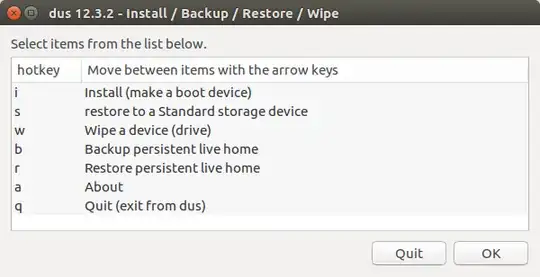

Once you click OK you'll see this screen. Choose "Install (make a boot device)" and hit OK: enter image description here
Then choose "Extracting Windows installer"

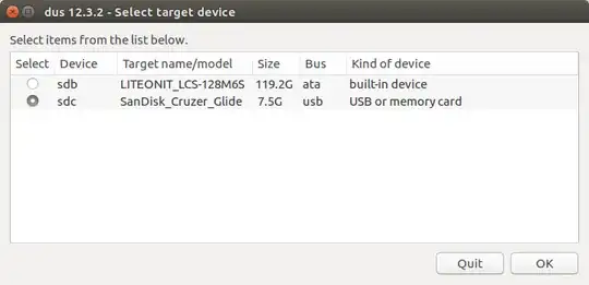

It'll then ask you to select the device you want to write to. This will overwrite all data on the selected device, so make sure you select the right one (in my system, /dev/sdc is the USB stick I'm going to put the Windows installer disk onto)

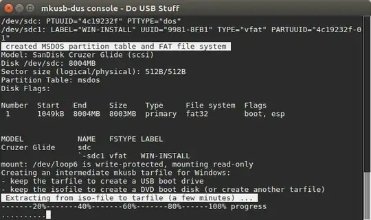

The console window will gain focus and you can watch the 'progress':
This will take many of your system resources and will result in some slowness on your computer at times, so you might want to go get a coffee or read the newspaper or take a quick walk. This will take some time to complete, because it clones the ISO to a tarball, and then extracts the tarball to the target device.

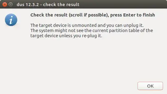

When it's done, the GUI will return with this screen if it successfully created the disk:
Hit OK, and remove the disk from your computer. You can then shut down and boot to the installer USB stick that was created.
