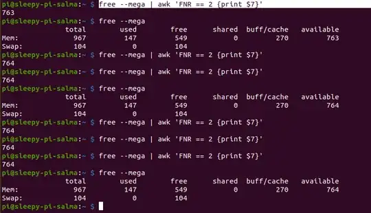

free --mega | awk 'FNR == 2 {print $7}' on terminal returns available memory in Mega. One can call it from python.
screenshot
This works for free verion: mfree from procps-ng 3.3.17
