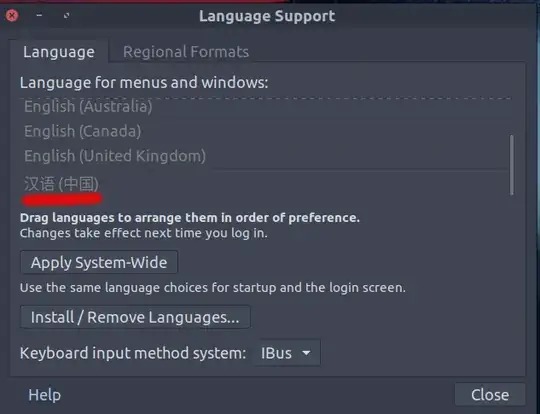

screenshot of Language Support
I have reinstalled my computer system with the Ubuntu 18.04 last night, and while I install the system I chose the system language is English but there is Chinese language package installed without my agreement now. (What happened exactly?)
I try to remove this language in the Install/Remove Languages... button, but when I open the language setting, the system warns me there is some recommended package not installed and want to install it for me. (I do not need it at all.)
So, is there any ways to remove this language showing in the screenshot?
P.s. I tried to upload the image many times and the upload page always says: Failed to upload image; imgur is rejecting the request. So, I have to use Google Photos to share this screenshot.

Thanks for Mr.Hjalmarsson's help.
Follow this Steps:
First, make sure that language which you want to make it disappear in this page is not set as the "regional formats" setting.
Then check the folder which in /usr/share/locale-langpack and using command ls like this:
ls /usr/share/locale-lanpack/zh
en  en_AU  en@boldquot  en_CA  en_GB  en@quot  en@shaw  en_US  zh  zh_CN
We can see there has a language folder which you want to remove like zh, this zh folder was created by the installer since you (apparently) selected a Chinese time zone location, so we removed it now.
sudo rmdir /usr/share/locale-langpack/zh
At last, we use the command gnome-language-selector to remove the Chinese language packages again and re-open the gnome-language-selector, the "汉语(中国)" will never appear.
If you can't see the "汉语(中国)", we should do some clean work after remove, so, just remove all of the folders which have the characters zh in the folders name.
