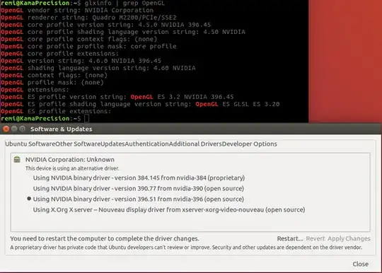

Screenshot of what it looks like and the available drivers
What I tried before that
A) Trying to change the graphical drivers
I have tried all of the available drivers through the "additional drivers" interface. It mostly doesn't change anything, except for the version 390 that completely screws with one of my screens (I'm on a laptop connected to 2 screens). With my current setup, the graphic card seems to be recognized well (cf screenshot).
