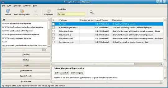

It might be the thubmnail generator, tumbler. what-is-tumblerd I removed it from my install because it was causing folders I open to task the CPU, and delay because it is making thumbnails for every file.
How to remove:
With Synaptic Package Manager:
Search for tumbler click on the check box for it and select "Mark for Removal"
With Terminal:
sudo apt-get remove tumbler
Note: Removing tumbler will ask you to remove xubuntu-desktop this is ok since it is a "meta-package" and will not remove xubuntu, https://help.ubuntu.com/community/MetaPackages
